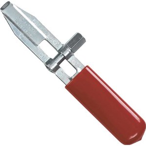

Ok, the tool to tighten the factory style clamp is this one,
can be bought here Amazon.com: Lisle 30800 CV Boot Clamp Pliers: Automotive
or here
Sears: Online department store featuring appliances, tools, fitness equipment and more
or any tool truck or automotive tool distributor.
The universal band clamp tool is this one
Can be bought here
http://www.amazon.com/KD-Tools-3191-Tightening-Wrench/dp/
Napa
NAPA AUTO PARTS
Or any tool truck, auto tool distributor.
The universal band clamps I use are by a company called Band-It.
Light Vehicle CV Boot Clamping
Unfortunately I'm having trouble finding an on line distributors for them. I like this style of clamp because its much like a zip tie. Just wrap it around the item being clamped, tighten it down with the tool, and cut off the excess band that wasn't used.
Other universal clamps like these, I'd opt for ones like the Precision's at the bottom of the page.
