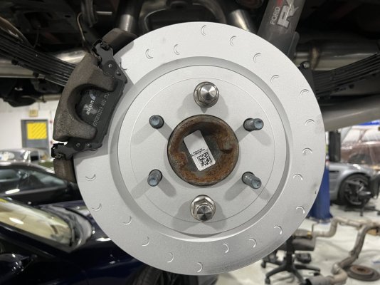

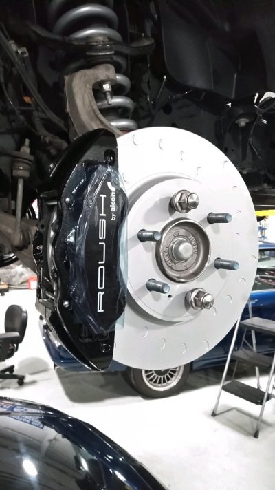

Just finished a big build and wanted to share some inputs on what might be my favorite addition:
Alcon 6-pot Front Calipers
Alcon Slotted Front & Rear Discs
Crown SS Brake Lines
Pros:
Brake pedal feel - Massive improvement. Less pedal mush, more consistency.
Brake grab - Its easier to find the engagement point at any speed.
Brake power - These will stop your shit fast and in less distance.
These are so good that it almost makes the stock brakes seem irresponsible.
Cons:
Price
Availability
Wheel options

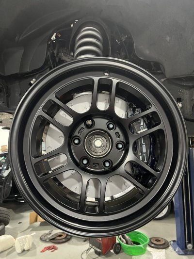

We were able to fit these with a set of 17" Enkei RPT1s (and will work with stock 17s) by using easy-to-find Grade 8 hardware from the local store. Took a little grinding off the leading edge of the head (1-2mm) to clear but simple enough.
Beyond the power upgrades done to the truck, these are the most noticeable improvement. If you're investing in go-fast parts, don't forget you also need to slow that beast down reliably and consistently.
Don't regret a penny spent on these, they work.

@raiderofthelostark nice! I’m waiting for my brackets to come in so I can install these! Which bolts is it you had to grind? I have the same wheels! Also is yours an electronic parking brake? I have only been able to find the rear rotor/pad set for the electronic parking brake trucks.
To fit under my Enkei 17s, we had to get smaller allen headed grade 10 caliper bolts and had to machine some of the top of the head off for clearance.
Electronic parking brake set - got pretty lucky on ebay
Do you have the calipers with the 2 bolts from the top, or the 4 bolts from the side? I'm waiting on the brackets for the 4 on the side, but they're saying an April 23rd ship date now. If you have the 4 bolts from the side, you shouldn't need to grind anything.
The two caliper bolts on the top. Needed new hardware and a bit of grinding to fit.
