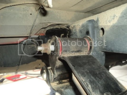

This is where the only mistake happened. When reassembling I put the spring bolt in the wrong way.
as you can see it will hit the frame...
This is how it should look...
Luckily this was caught before anything was tight..
