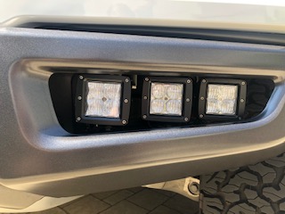

This is what I did in the 1st few weeks of ownership. 2019.
I got an unseat storage locking box from esptruck.com. It's way stronger than a Tuffy, thicker steel..https://www.esptruck.com/product-page/ford-f150-2017-raptor-under-seat-storage
I installed a BakFlip MX4 tonneau cover from tonneaucovers.com....see pics, something like $750 vs $969 direct from BakFlip
I installed GG Fog lights, the 3 cube design all white and a curved RC light bar behind the grill, well I had them installed professionally, lol.
Also I can share the wiring harness color guide for the '19 and '20 Raptor that the AUX switches connect to on the top in the cabin.
Whew. Here are the pics.
I hope this helps anyone who's interested in lighting and storage covers.
Thanks, MK
