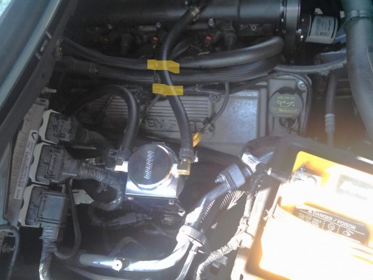

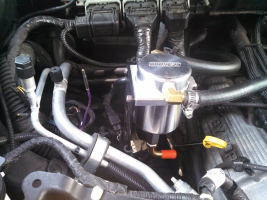

It looks like JLT has updated the screen in their cans at some point. I’ll reach out and see if mine is the older style. That check valve looks nice. I’ll see if I can find one in stock somewhere.
Where exactly did you place that in your system?
As long as it's in between the SC and the catch can you're good.
With the JLT, you have to clean often.
Plus, using the right oil like Mobil 1 Extended Performance is key to keep the vapor mist down in the block.
And switching up to W5-30
