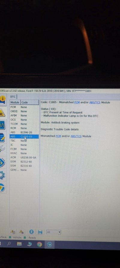

Code C1805 PCM for ABS module mismatch
I've checked the coding as compared to the ford as built coding and it's the same, tried to flash it thinking maybe I would have the opportunity to add the vin to the module if they didn't do it when the module was replaced but it's not an option.
I've done the on demand ABS module test and Forscan says test successful or something like that

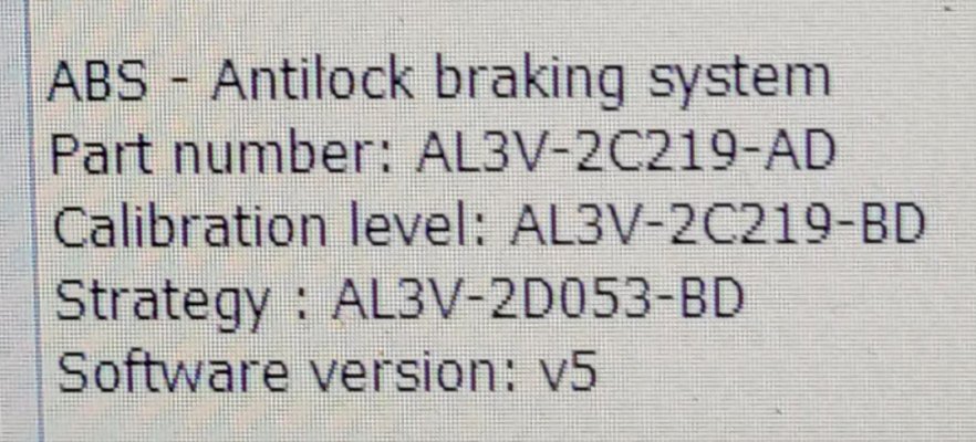

The pic below is the part number AL3V-2C219-AD from Forscan which does not match what I have researched and think to be the correct part numbers
ABS Module AL3Z-2C215-A superceded by AL3Z-2C219-J
superceded by AL3Z-2C219-N
But the part number is pretty close to the manufacturing/engineering number AL3V2C219BB that the dealer parts counter suggested I use to look for a used unit.
