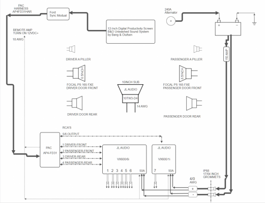

I am not liking the B&O sound system that came with my 2023 truck and looking at doing the lower diagram, any comments if anyone has had experance with these products?
It seems there is a "T" harness that might not be shown but i am planning on running new speaker wires for the new speakers, not sure how the blue tooth will handle this set up but the roof speakers crack bad...
trying to decide on what rear speakers to run and if i should use a coax and if i should run them in mono?
lastly should i use a center or not? I am not planning on hooking up the roof or headrest speakers... they seem unevenful, dash L/R speakers I am not planning on keeping hooked up either.
thanks for any advice in advance.

Pretty sure you are wasting your money running new wire for the system you are showing above. No need for center, dash, headrest, or roof speakers. My setup from Soundsgoodstereo is similar and sounds great.

Looks like a good system, do not run new wire that is AC Current (Signal - Speaker Wire) as it is not needed. High voltage, low amperage. Here is a nerdy article written by a famous engineer on this topic. But you do need a 4ga wire for the DC Current.

if i were you, i would use a different subwoofer. audiomobile is an awesome speaker. very musical. since the jl audio wont fit behind the seat, you are using under the seat. might as well go with a better sounding speaker if you are giving up the space. another note, you dont necessarily need the vxi amp for the sub. i believe the speaker amp has adjustable eq, gain, etc for channels 7&8 as an rca output.

Not a fan of the PAC solution. Makes you go behind the radio for no reason. and any time they say they are converting high to low, I run. With the ZEN A2B, you pick up all connections in the back of the cab by the amp and CAN BUS. Spend the extra money on the ZEN, it is a better solution.
