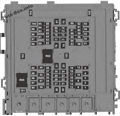

Sorry, I couldn't find where the hell I saved it. Now I copied it in my pictures and my docs. By the way, don't be ***** like me and forget to double the ratings for each light because they are not rated as a pair. :banghead:
So I said to myself, Self, what exactly is he saying? Some of the upfitter switches are rated at 15 amps. I looked at the website and the spots are 3.3 amps each. That should work on any switch, or so I thought. Even with the description of the wires above, I screwed up. I connected the innermost driving combo to switch 1 which was fine. I then connected the wide, outermost to what wound up as switch 4 and it was fine.
Then, like a jerk, an f'in moron, I used the wrong jaw of the plier to squeeze the crimp portion of the wire and cut it right off. That was a real PIA. But I connected it finally, the spots went on and immediately off.
Did I blow a fuse?
I then connected it to one of the two remaining wires and same thing happened. From one pair of lights.
I had one wire left, connected to it and it worked fine.
And to think last time I had two pairs of lights on one switch. How could one pair rated at 3.3 amps each light blow 2 fuses? And where the hell are those fuses? Do they only control the upfitter switches?

Switches 1-2 are 15 amps
Switches 3-4 are 10 amps
Switches 4-5 are 5 amps.
1 pair of Squadron Pro or Racers can only be used on Switches 1-4. Switches 5/6 don't have enough amperage.

Don't the gen 2's have lit up upfitter switches? are the lights on? Switch is good. Do you have a meter or not? Lets start there.

Switches 5 and 6 are only 5 amps, if that's what blew. That's what I did. I was thinking 2.9 total for my Squadron, not 2.9 X 2, and I blew a couple fuses until I figured out with some help from in here what the heck I was doing wrong. There is a specific fuse for each switch in the box near the battery. Those freaking fuses are about $8 each and can be a little hard to find replacements for. I think they are called M case fuses if I remember correctly. I had never seen them before, a weird fuse that looks like a little box.
If the lights went on for a second or two and then off, that's what mine did when I overloaded the low amp switches and popped the fuses. #6 is fuse 62 under the hood to the rear of the battery. That was my preferred one to pop a few times until I figured out what I was doing wrong.

Assignment of the fuses in the Power distribution box (2018, 2019, 2020)

so I need to replace 9 and 62. TYVM.
Hey, look at it this way, now I'm not the only one!!! :Big Laugh: I was ready to bang my head against the wall trying to figure out why the fuses were blowing when OBVIOUSLY I wasn't overloading them. :emotions122: If you want to use 5 or 6 you can throw a relay on it and still use it. I wanted my Racer Spots all the way to the right (6), so I just wired a relay into that circuit under the hood.

It would be very difficult to swap what switches I’m using now as the wires are crimped inside the harness. I’ll just wind up labeling them and probably have dealer change fuses when I do first oil change.
