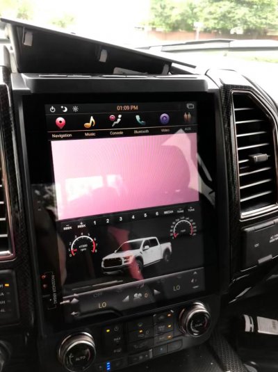

Thanks I just did that stopped to get gas and turned truck back on and now still have the flickering console of death. Need to find an update or a way to reset it to get console to work again. Only solution I have found so far disconnecting and reconnecting sync cable.... Frustrating.....22a190580feac25b29966816b50eca69.jpg
