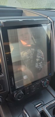

Third issue is when I get into the truck in the morning and start it the screen has nothing but vertical static lines as if the LCD display driver has failed. I have tried checking all wires and connections. Also tried leaving the unit loose in the dash over night to make sure something was not pinched. Still the same issue in the morning. Once I press the reset button for over ,30 seconds it reboots and then it's working.

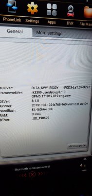

I'm having the same issues with the flickering screen (static lines) when I first start the car. Hitting reset would usually solve the problem, but then I encounter other issues like no sound from apps - only sync. I finally got in contact with Phoenix Tech Support and they sent me a new firmware to load. Apparently, they just updated the firmware on 11/18. Going to apply it later today and see if it resolves the issue. I'll let you know when I do and I will also include my system information in my reply.
