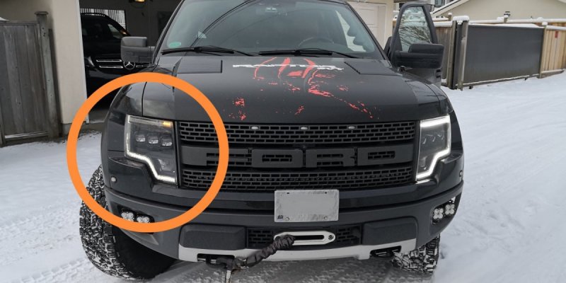

I will try to describe, also attached a video I took this morning, you will see the lights reflection in the glass...
Gear in P, looks normal...
In R, both sides off, 3 dots blinking passenger side.
In D, passenger side off, 3 dots blinking...
Back in P, passenger side back on in 1~2 seconds.
:whymewhyme::whymewhyme::whymewhyme:

Double checked this morning, when the headlight ON, it functions perfect normal. Headlight OFF, it doesn't. DRL issue?

Did you disable the factory DRL’s before you installed the morimoto’s? If not, that could be your issue if you have a Canadian truck

Yes, canadian truck, DRL not disabled. The shop doing my retrofit told me to disable DRL too. Might fix that probelm. Ordered a forsacn obd2 adapter already, watching forscan how to videos on youtube now, lol... no experience on that.
