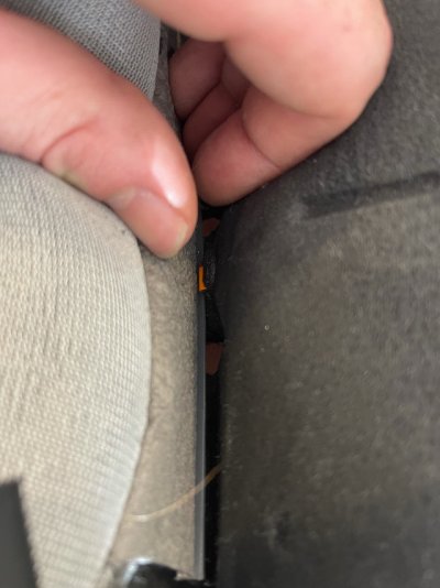

Fabric I stuffed down into the crevice to hopefully help prevent issues in the future.
Problem area that sat in the same crevice as above.
Old element and removing the hook and arrow attachments.
Image of the hook and arrow. This was the part that made me the most anxious to do the repair.
There are no good images online so I had to go with the Ford repair manual and wing it. The gray bar
is attached to the orange part. I inserted a small flat head screw driver, twisted it, and pulled the gray bar out.
Worked very well.
