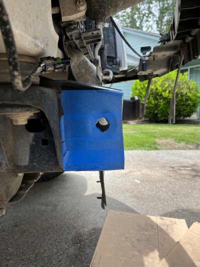

Installed the bumper yesterday and for the most part was pretty simple and straight forward. It was a learn as you go kind of thing for me so i'll share some of my learnings. First off i there are really no instructions on where to cut the frame and it does use the existing hole so be carful not to cut too much off. 4.5" from the back part of the horn seemed to work out for me. The angle cut was a little difficult so i made a straight cut first then held up the new horn and scribed a line and made my cut. I started with an electric grinder for the first cut and that's a bit unwieldy especially sitting and kneeling under the truck. Maybe jacking it up a little would have helped and definitely a lift would be ideal but i did it just sitting on the tires. I used the grinder for the passenger side and it worked out, but the drivers side i decided to use a reciprocating saw with a long blade to make my first cut all the way through. That went way faster and was much more manageable and had the advantage of not throwing sparks everywhere. It also gave me a pretty even cut straight down. For the angle cut i used a cordless grinder and that worked really well too. its a little slower but didn't throw as many sparks and was a little easier to manage. After the cuts i cleaned them up with a flapper wheel and hit them with some primer. The one issue i had and Ken mentioned it in my previous post, is the horn is held on with one through bolt so on some frames it will rock, even when tightened. I happen to have a lathe in my garage and happened to have some stainless tube so i made 2 sleeves to go between the frame flanges so when you tighten the bolt, it doesn't deform the frame. After bolting everything up i had no rocking and the bumper looks great and feels solid. Really happy with the way it turned out and how it looks.

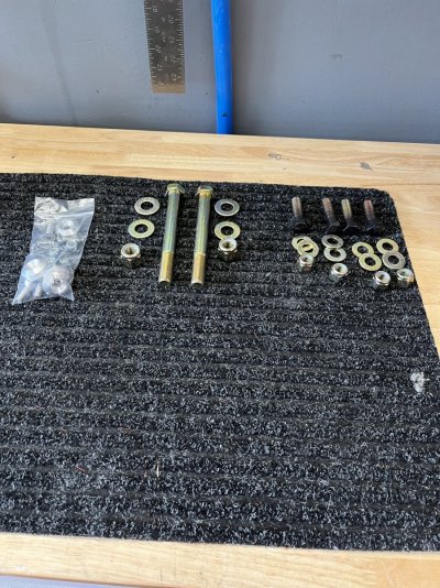

Hardware. Power coated the bumper bolts to blend in with the horn.

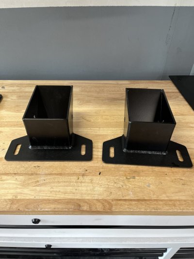

new frame horns. Beautiful tig welds
Passenger side first cut
Little tough to get a straight cut with the grinder. Not a big deal since the horn covers it.

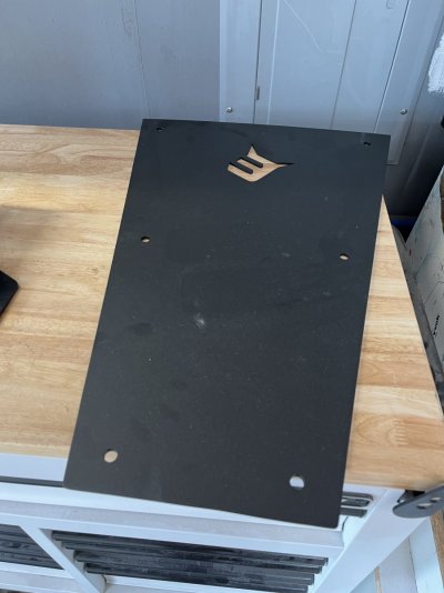

(You may have already done this, just wanted to throw it out there. )
If you're going to use the truck to do Raptor things, trim the skid back and layer the lower bumper mount over it rather than under it. The way it is in one of the photos is going to get it ripped off. Bumper looks awesome, it's rock solid and built to take some abuse.

I haven’t installed mine yet. Was debating doing the front diff service while it’s off. Did you actually cut the skid plate to shorten it? I noticed the front bolts were covered by the bumper and the middle set were commons to both I’m thinking 4 bolts is plenty for the skid
NateMob
Sep 15, 2021
402
482
SATX
Yep, we trimmed it a couple inches or so per the instructions and it tucked underneath perfectly. Once trimmed and layered the skid holes line up with the lower bumper mount holes.
