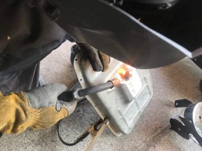

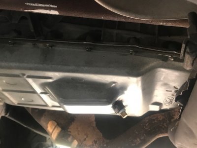

Sal drilled a small hole in the cover (see pix) to easily drain the trans fluid into a bucket, & measured just over 7 quarts drained. Given the 127K miles of wear, it is advisable not to flush out all the fluid at once. He installed an easy way to drain & fill the tranny, so I can do it again in 20K miles in my driveway. The drain hole was expanded on the bench, and a threaded **** welded on (see pix). Then he installed the engine-bay-accessible dipstick, & easily refilled with new 7+ quarts by zip tying the funnel to the hood (see pix). The dipstick’s fill accessory had to be heated to fit over the bottom of the funnel. The wheel wells took 2 hours, the trans 2 hours, and then the diff cover another hour at the most. He sprayed clear coat on both the diff & trans covers, & suggested I replace the trans plug with the type that is more protected & recessed & takes a hex wrench to remove.
