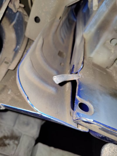

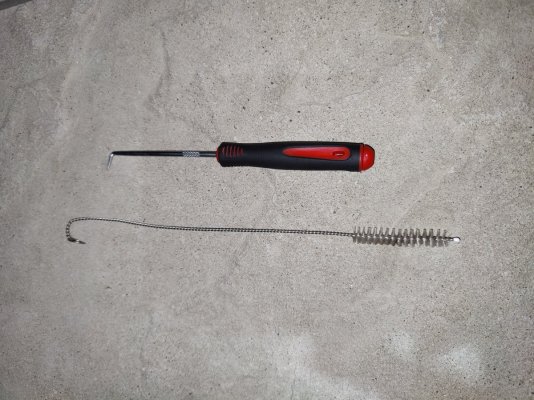

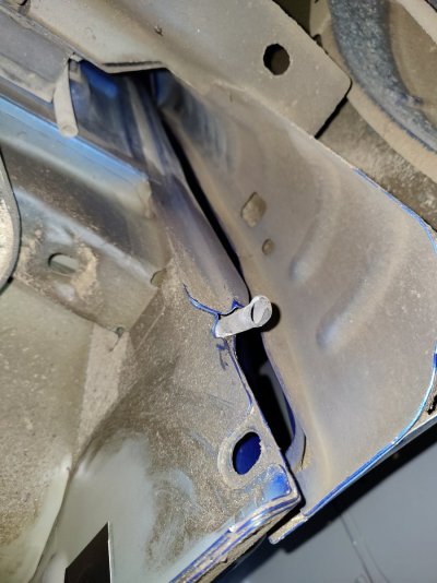

Hey guys. I decided to reroute my drain tubes through the holes that @matrix243 elected to fill. I used a wire straw cleaner to hook the hoses. Once they were close enough I switched to the 90° pick to pull them the rest of the way through. Seems like this should work find but I will watch to make sure the hoses don't get clogged with debris.
Also, my driver side hose was a few inches longer than the passenger side so I don't know if the passenger side would have reached the rocker panel holes anyway.
