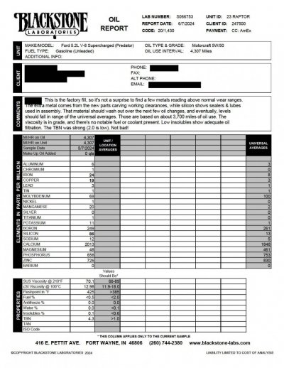

I realize there are some other oil threads, but I thought this might be interesting to some. Picked up in Aug 2023, first oil change at 4,307 miles. Results are for the factory Motorcraft 5W-50. I refilled with Amsoil Signature 5W-50 - it will be interesting to see the Amsoil test results next time around.

I love the Blackstone analysis!, I recently had the second sample tested from my 2017, I had changed oil flavor/type between the two analysis and the report showed an improvement at 130K, very comforting to read a report like that,piece of mind!

Do they still have a 2 month lead time?
Nice to see 5-50 being used in that engine from the oem.
