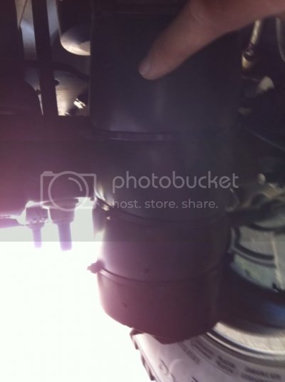

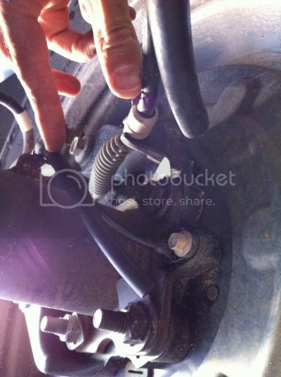

I noticed after the Raptor Run that the underneath of the truck more specifically the plastic shock guards get beat to hell from rocks and such, I also noticed the emergency brake line and ABS lines are subject to flying debris, so I covered them in vacuum hoses.
Problem solved!
Just take a vacuum hose and fuel hose, cut to length, slice it up the middle and cover and protect your lines.
For the rear shock I just took some very thick kitchen drawer liner and wrapped the shock a few times.
