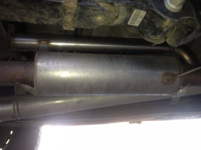

Since I bought my 2013 Scab which had a full custom stainless steel exhaust line, I found I had an horrible drone between 1500-2000 rpm, especially when engine/exhaust was cold, and i'm really not ear sensible, custom exhaust is the first mod I do on my cars & dirtbikes but damn that was too much for me...So after reading several threads on FRF about drone issues and Helmholtz resonator, I decided to go this way...And well I couldn't expect that little thing would be so effective...
No more drone, I can now drive on the highway in 6th gear without getting mad and/or deaf...Cool thing is that it doesn't really affect the sound of the exhaust, maybe just a little quieter, yet without that drone I can now really appreciate the exhaust more clearly...
Best solution I could have for only 80$...Easy and cheap, hope this will help some members here that have drone issues to bite the bullet...
Dimensions :
Diameter : 60mm (2.3")
Length : 650 mm (25")
