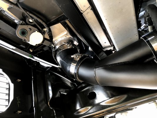

Funny enough, fitting the new piping and connecting hose took me the longest. It's not hard but it's some trial and error in terms of the order of which to attach things, plus, I'm pretty **** so I took it slow.

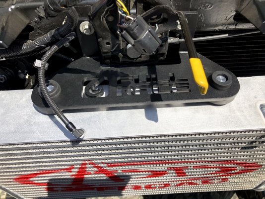

I recently read somewhere on this forum about a mount bracket for this intercooler made by RPG I think - from what I remember the person said that the IC is mounted to the lower frame and the 'upper frame'. Well, both are false. I guess his point was if they both move in different directions, there could be trouble. Here's the deal, the IC isn't actually bolted to anything - it is a floating mount system that reuses the OEM rubber grommets. Movement from the upper and lower mount won't be an issue.
Here is a pic of the upper mount

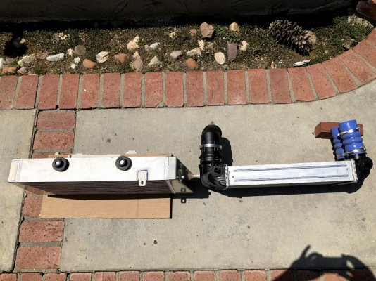

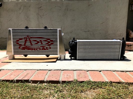

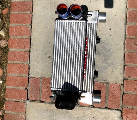

It is surprising how much is removed off the truck for the OEM IC. Here are a couple of shots with both intercoolers to give you a good visual. OEM is tube/fin and the full race is bar and plate which i much prefer in air to air.
Just say no to plastic end tanks :mad:

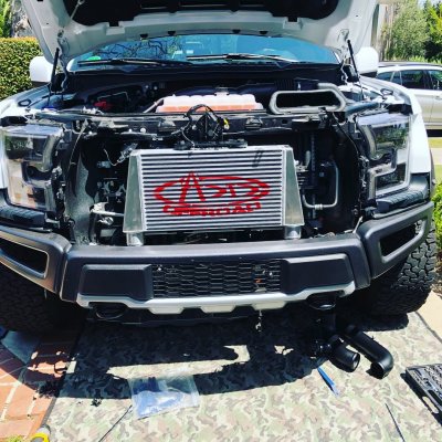

I've heard people with concerns about the intercooler blocking the trans cooler, ac condenser and the radiator... I went for a good drive today and noted completely normal temps - I forscanned to have the degree readout over the gauge - water and trans were cool as usual. If anything, the truck may be being cooled more now that the IC grill area blows straight into the engine compartment. Also, the cooling fins on the full race IC and not dense at all, air blows right though it so stacking isn't an issue.

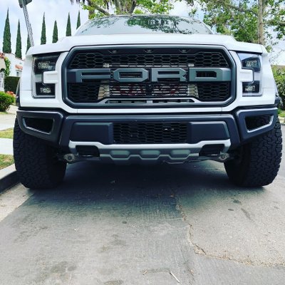

To get this IC to work you do have to cut your grill. You have to cut the inner bottom part that is by the bottom of the IC. The grill won't fit unless you do this, that is one caveat. You also have to cut the center support out of the grill. Basically, you are performing mods to the grill that can not be undone. You remove the louver system then cut the louver support out altogether. Still trying to figure out when having zero air getting to the radiator would ever be a good thing...

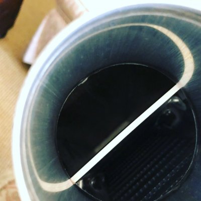

Love the dividers which forces the use of the entire core:
And all done!
