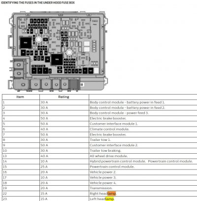

Hi All, does anyone know what fuse(s) drive tail and break lights? Bonus points if you can advise on marker lights too. Manual only lists fuses 22 & 23 as headlamps, but can't seem to find anything on the rest.
Trying to figure out if there's a way to blackout the vehicle on the outside for offroad driving only.
Thanks!

That is not the way it works now in these computer controlled vehicles.
All the lighting is controlled from a Body Control Module.*
That is why you don't see a dedicated fuse to the left and right lights in the fuse list.
As well, they are part of a minor Bus circuit as part of the Can -Bus System.
To light most all lamps, the headlight switch only signals the BCM* to close power to said light via a Solid State device.
Not like old times where you switch power direct to a light from a dash switch.
https://www.f150ecoboost.net/threads/tail-light-fuse-location-and-number-on-fuse-diagram.88548/
Seems to be BCM controlled.

Thank you for this info. I promise I searched before, apparently not very well. Much appreciated.
