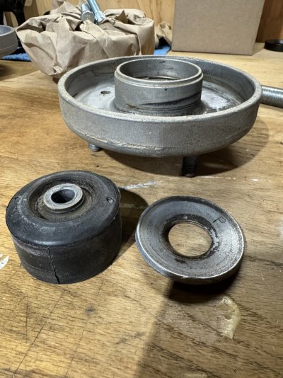

Now for the fun stuff. To take the top hat to the limit, I put it in a 20 ton press and pushed down on the steel at the top of the bushing until it went bang. This is what the parts looked like after it had failed:
Notice the bushing is entirely fine. This bushing has about 25k miles on them including things like whoops. As you can see, the washer has been turned into a bit of a cone. It is kind of hard to see in the image, but the cone shape is not subtle at all. I have not seen a failed top hat with the washer looking like this. So, again, I don't believe the washer is the issue.

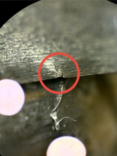

Moving on to the retaining ring area. When we talk about retaining ring failure in an aluminum part, we are really talking about failure of the retaining ring groove. Before we get further, for those of you who aren't familiar, aluminum is particularly susceptible to fatigue. Unlike steel, it does not have a fatigue limit. That means eventually any aluminum part will fail. The goal in design is to make sure the number of cycles to failure is more than what the lifespan of the part needs to be. Since the retaining ring is still in the top hat, if fatigue around the retaining ring groove were to be a concern, there might be signs after taking the top hat to failure like this... and there were.
Glancing at the retaining ring ends after the explosion, a slight discoloration was noticeable to the naked eye. I suspected this might be the start of a crack, so I threw it under a microscope for a better look. This confirmed my suspicion. A small crack had initiated adjacent to the end of the retaining ring. This makes sense because there is a stress concentration at the ends of the retaining ring. Cracks will always continue to grow after they have started unless measures are taken. The growth of this crack was accelerated by the extreme force it was subjected to, however, because aluminum has no fatigue limit, it's likely this crack will always form. The name of the game if you were designing this top hat would be ensuring no catastrophic failure over the lifespan of the part.
My theory, then, is that certain scenarios lead to accelerated growth of a crack at this location that ultimately results in the retaining ring/retaining ring groove no longer being able to retain the washer and, in turn, the bushing. There are two things that would primarily contribute to this: stiffer springs and heavier wheels. Since this is a failure at top out, heavier unsprung mass generates a larger top out force. The increase in top out force would be roughly proportional to the increase in unsprung mass. Stiffer springs are kind of self explanatory. The rebound tune is based on the stock springs so with stiffer springs you get higher rebound speeds. It's all pretty much like swinging a hammer. The hit is harder if the hammer is bigger and/or it's swung faster. I think the 35 and 37 trucks will largely be fine save for defects, but since the Raptor R has stiffer springs, there is a chance it's susceptible to this in its stock form.

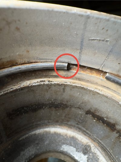

Great write up, but I would offer a different root cause. If you look at the picture above, you can see the ring is not seated in the grove and has corrosion behind it. All the force was being supplied only where the ring was seated as you pointed out. A properly seated ring would have prevented this problem. Just look at the difference in the ring end and an inch or two to the left in your picture.
The top hat is cast aluminum so it would be white in color if it was corroding. That brownish stuff is dirt. That top hat had about 20k miles on it including some very fine silt with a high clay and iron content. The retaining ring was entirely seated. The way they have designed the washer actually forces the retaining ring back into its groove the harder you push down on it.
I think you have galvanic corrosion. IE: dissimilar metal corrosion. You can see the dust on top of the ring and some in between the ring ends. The ring groove is machined so I bet it’s round. I suspect the steel ring is not as round under tension or has work hardened. Just my 2cents. Great write up and analysis.

Seattle
One would think we could adjust the rebound damping to address the spring rate or added weight.
That dust is definitely dirt. The top hat was absolutely covered in it. I tried to clean it off as best as possible, but some just won’t come out. You should see my engine bay. You can even see it down where the bushing sits. In person at least, it does not match the corrosion of aluminum, steel, or zinc. I’ve done some salt testing on these things and they actually hold up a lot better than I would have thought.
The steel ring is definitely not round. Cross section is likely a little taller than it is wide. That would be a contributing factor to the stress concentrations around the whole ring. Under load you’ll see deformation of both the ring and groove. The fact that people do the same thing over and over with no failure and then one day it blows up is a sure sign of fatigue.
