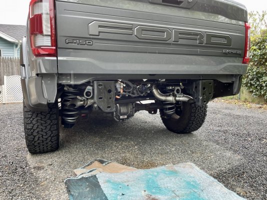

First step I did was cutting the exhaust tips, added some turndowns with clamps from summit.
Next I removed the rear bumper, starting with all the sensors, trailer plug, and other accessories. There’s 3 nuts per mount that need to come off to remove the bumper in one piece.

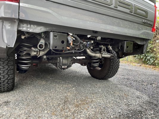

I cut the bumper frame mounts using a grinder.

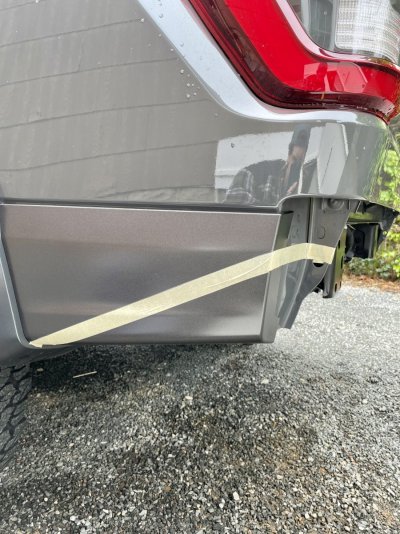

Followed this with the dovetail cuts.
After cutting I hit every surface that was cut with a few coats of matte black paint.

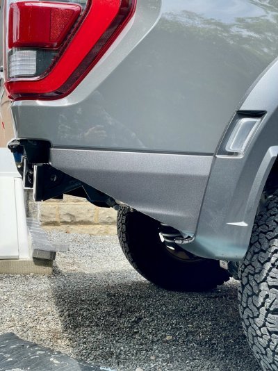

Final product for now. Waiting on some trim to come in to finish the dovetails.
All said and done it’s a pretty involved process, but the end results were way worth it. Will update with some more pictures when I get the trim installed.
