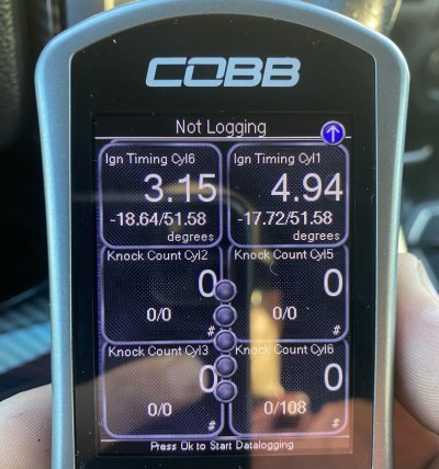

I am getting a bunch of knock picked up on only cylinder 6 causing timing to be pulled and loss of power. I had the warm phaser audible knock so I replaced the phasers and the sound is gone. Thought that would have fixed my issues but it didn’t.
Tried switching plugs and coils around and the problem doesn’t move. Will do it stock and with the Cobb tunes. I’m running 93 octane and the truck has plenty of power when it’s not picking up the knock/pulling timing. Seems to do it the worst when I am rolling into the throttle in 8-10th gear.
