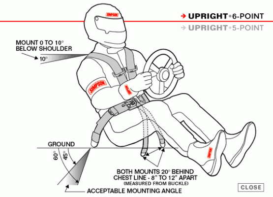

....Maybe have some kind of bar fabbed up.....
I am still debating on that. I want to fab up a hoop but do not have the time right now. I am going try the old trick of using the bolts that hold the seat down. I have an extra long set of belts that I did this trick to in my GT500 for my very first race and I think they may just fit.
Both of these are horrible idea's. The whole reason to put 5 points in the cab is so that your body doesn't move, well what happens when you go over with harness and no cage?
Now if you mount them to the floor your asking for major back problems when you compress your spine.
If were going to bring up safety, please make sure your using the tools correctly, otherwise they can/will hurt you more then help you

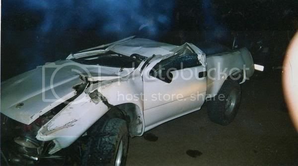

When someone flattens out the roof in a roll like that, it really doesn't matter what type of belt or harness you use if there is no cage. That being said, even if you don't have a cage, one could stand to reason that a harness could be useful from a driving standpoint just in the sense that you're jostled around less when maneuvering.

Sorry if you felt that I was bashing your idea's. I in no way was trying to do that, I may sound very harsh and thats just how I come off to people, but that was not my intention. As far as my solution, just use the stock belts, they are not great for hold you in place, but when you have to move really fast, you have the ability.
There were 2 guys in the Toyota that I posted, both of them walked away with no more than scratch's. Now if they had been in 5 points they would both be dead.

It's all good Bro, no love lost. That's pretty incredible that they weren't injured badly! Help me out here, because i'm not fully comprehending the physics of your last statement on my own... I think what you are you saying is that the regular seat belts allowed them to tuck inwards more and lower their heads during the crumple whereas harnesses would've kept them upright and not allowed them to duck away from the crushed cab.... Is that what you mean??

Yeah, no harnesses w/out a cage is what i've always been taught! A harness just holds you in place a little too much, but the when the cab is collapsing around you, your body needs to be able to move out of the way.
SilverBolt
Hired Gun
Jan 12, 2011
3,461
2,671
Portland, OR & Eureka, MT
It's critical with harnesses that the mounting points are in the correct position. Shoulder harnesses mounted too high won't keep you in the seat and mounted too low will compress your spine on impact.
My guess is that the seats did the normal thing of collapsing backwards and lying the driver and passenger on their backs.
