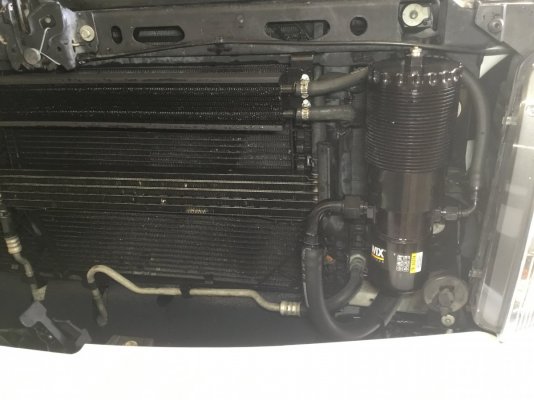

I’ve been needing to flush my p/s fluid, it was turning dark, so decided to add another cooler and a larger reservoir. Having to remove the S&B CAI tube to get to the stock reservoir was also a nogo. A ton of great info on the forum to do this so gave it a go. Maybe even prolong the life of the p/s pump.
Kartek reservoir, Derale cooler, some AN fittings, and hoses. Fabbed up some mounts for both and hooked things up.
Filled with fresh motorcraft fluid, flushed the system, and within minutes the system is quiet as a mouse. Plus having the return line right there in front next to the headlight will make future fluid flush maintenance a breeze.

How did you mount the reservoir and the cooler to the truck?

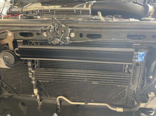

In the first picture is the mount I made for the reservoir and drilled a couple of holes for the clamp I got for the reservoir from Kartek. In the second pic, you can see a couple of L-shaped brackets I bent for the cooler to mount to the bottom of the radiator support.
