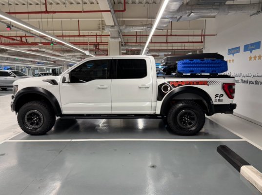

Last December I installed all four springs (front and rear) on my 2022 35 Raptor, the issue is the ride is stiffer than before at the front, especially on the speed bumps. I heard that the front springs could damage the factory top hats and I was told that I should replace the springs with SDI top hats or Foutz Top Hats.
By replacing the front springs with SDI or Foutz top hats will the ride be smoother than what it is now?
Will I get the same height as what it is now or it will be back as stock height?
What is the difference between SDI and Foutz and what is your recommendation?

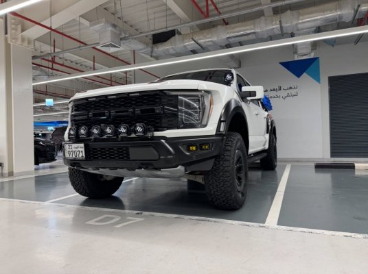

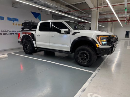

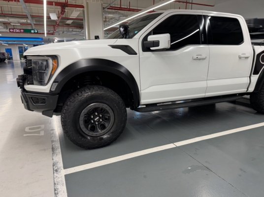

Here are some photos of my truck (it could look it is squatting a little on the rear).
Note: I’m Overlanding on the truck.
