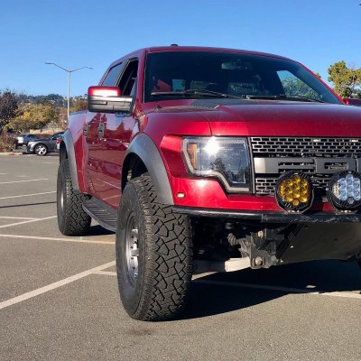

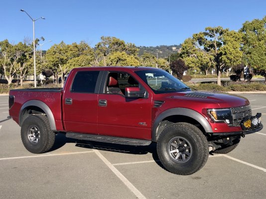

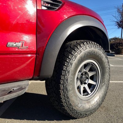

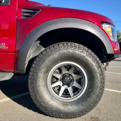

Finally got my 37x13.50x17 Gladiator XComp ATs mounted on the new Icon Rebound Pros 17x8.5 6mm offset in Titanium. They match pretty closely with the gunmetal fender flares which I like. The clearances are tight and the driver's side is rubbing just before full lock, but I put in a few hours of fairly hard offroading and they didn't rub on compression... I haven't jumped it yet however.
