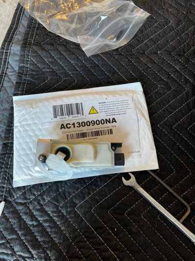

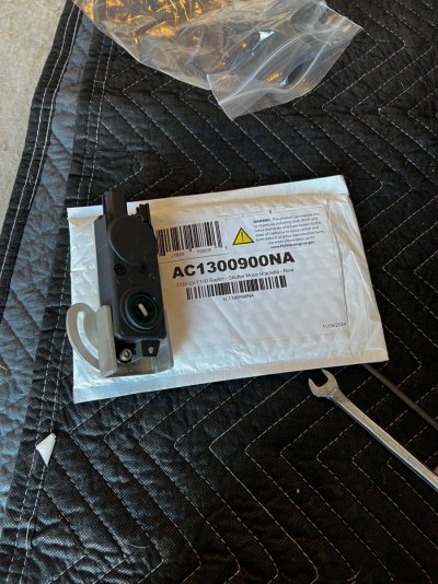

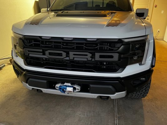

I installed a Warn winch mounted to the Swarfworks mount which of course involves removing the upper and lower shutters.
On my previous 2023 Raptor it did not set off the engine light but their was stored codes in the background.
On the new 24 truck it actually set off the engine light although the upper and lower shutter motors were plugged in.
The only shutter delete kits I could locate are from ADD and stated for lower shutter relocation. I bought 2 sets and can confirm it fit the upper and lower shutter motors and the engine light has stayed off finally.
