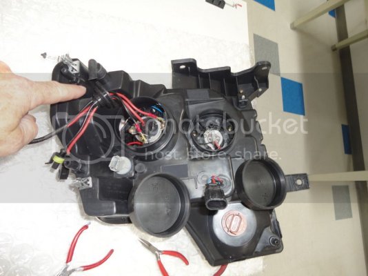

Remove cap over the projector low beams, undo wire hold clip, remove H-7 bulb and remove connector from back of bulb. Be careful to not touch glass on this or new one, set aside old bulb. Remove wire connector from old harness by inserting flat blade screwdriver to release clip on brass connector as pictured.
I found some extra strands on the oem harness needed to be cleaned up. I wrapped in some electrical tape on the sharp side and slipped some shrink tubing over the connectors before connecting to new harness. Black to black, Blue to Red. Made the connections, shrunk the tubing.
Next step is to cut 25 mm round hole in back of rubber cap. I used the packing washer from the new bulb as a template, it was pretty close at 27 mm, so I drew thick black line using sharpie and cut to inside (smaller) with razor blade (no exacto knife at work.)
As you can see I hacked it up pretty good, but it works fine and irregular cuts are completely hidden under rubber grommet. Re-install cap, I moved inside wires to side so nothing is pressing on inside of grommet.

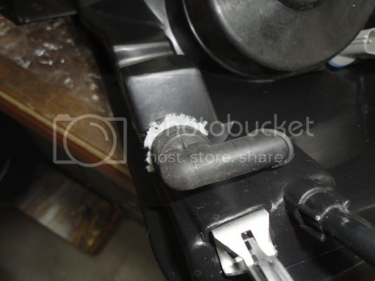

I do have concerns about dust getting thru this opening and decided to add a cloth filter.
The first one I simply slipped the cloth between the rubber and plastic, the second one I zipped tied down as it seemed like it might vibrate off. After sleeping on it, I am going to remove both lights again and try and come up with a more effective dust shield. I am now thinking that dust will simply go thru a single layer of cloth. I am also going to JB weld the metal side clips on one unit as they will no longer stay in place (Installation boo boo)

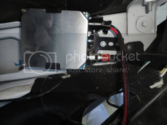

Before installing the light housings, I decided to install the Ballasts to the cross frame member. A couple of self taping metal crews made for short work. The right side needed to be angled due to rubber shield connected there. DSC02348.jpg
Connected ballasts to housing, installed ballast into bracket, reconnected oem harness – 3 connections, tested and then bolted back in.
