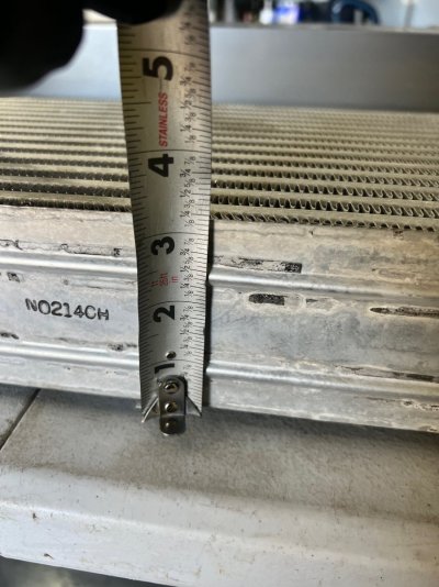

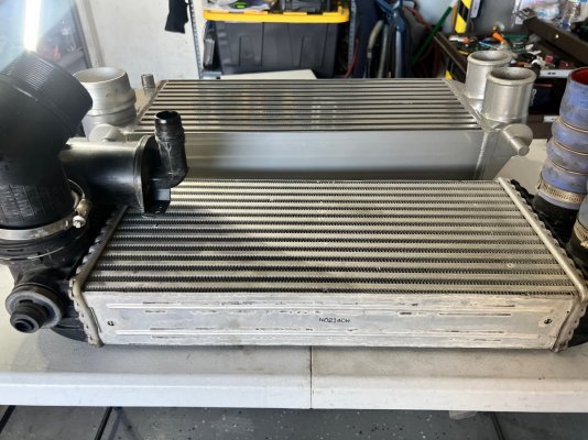

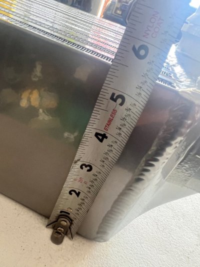

Core is definitely thicker than OEM. Definitely higher quality and finish than OEM.
(CVF Titan v2)
OEM
Compared side by side (CVF Titan v2 back) (OEM front)

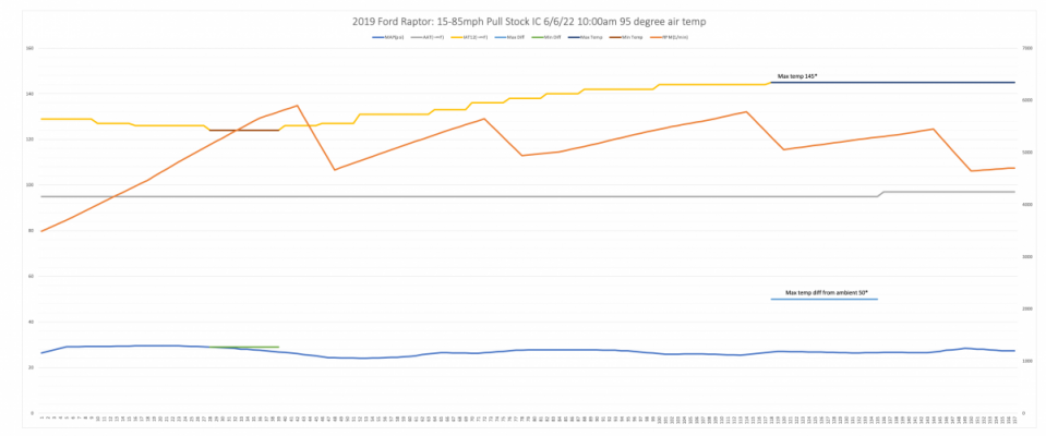

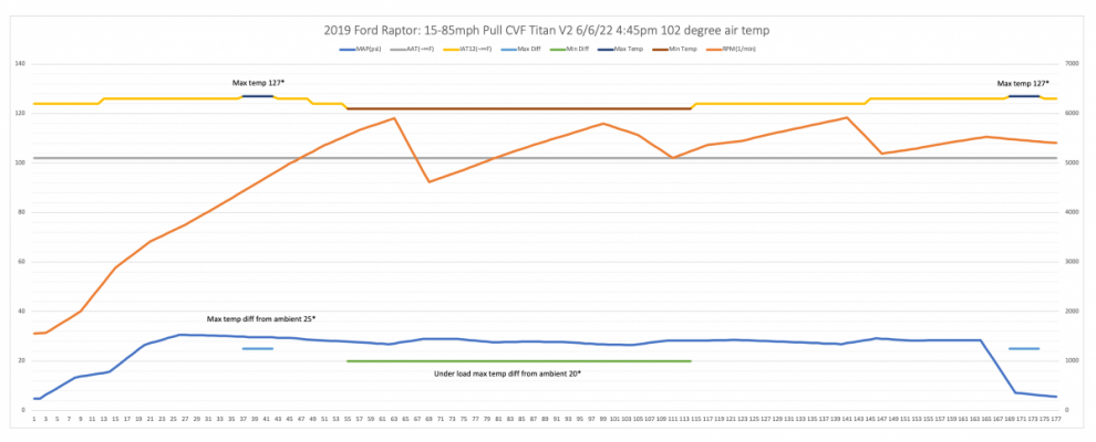

I used Forscan lite to datalog runs. Did 3 15-85mph passes with 5 minute cool down in between to simulate real world conditions and to add gradual heat-soaking.
Baseline 3rd pass: Maximum charge air temp was 145 degrees (F). Ambient that morning was 95 deg (F). Maximum difference from ambient 50 degrees (F).
Post CVF Titan v2 install - 3rd run: Maximum charge air temp was 127 degrees (F). Ambient on that afternoon was 102 degrees (F). Maximum difference from ambient 25 degrees (F).
(CVF Titan v2)
OEM
Notes:
- The ambient temp rose that afternoon after the install.
- Notice during mid-pull and at load the charge air temp started dropping to 20 degrees (F) above ambient.
- While max temp difference is only 25 degrees from ambient, it's very short transitory. Compared to stock where temps gradually climb. Majority of the pull the temp actually dropped to the lowest diff from ambient (better) longer duration.
