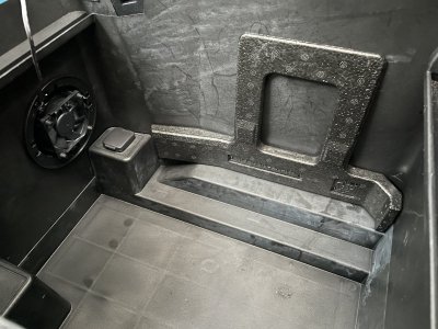

Install: Pretty easy and the instructions are super easy to follow. Heads up that you do need 3-1/2" hole saw to drill through the front of the center console for the fan to exhaust heat from the compressor. Dometic because as great as they are, include a very high quality plastic plug for this hole in case you want to remove the fridge in the future and go back to stock. Other than the hole saw, tools required are only a flat head and #2 Phillips screwdrivers. It should only take about 30 minutes but was about 60 for me because I wanted to remove the trim around the cup holders and shifter to make sure I vacuumed all the scraps out 100%.
You'll notice the INCREDIBLE attention to detail on Dometic's part during install. Here's a pic after the fan is installed. Just look at the custom high density foam inserts with adhesive already installed to hold the fridge tight in place. The only thing you need the flathead screwdriver for is to tighten the retaining clip that spins over the 12v plug. Why? To make sure it won't pop loose while off-roading. Genius! Then there's a few clips that hold the fridge down tight to the factory ridges that the coin tray slides on.

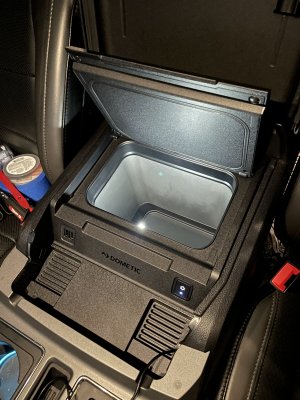

Operation: Beyond simple, there's just one button. Hold for a second to turn it on, or hold for a second to turn it off. It has a built in battery monitor so no matter what, if voltage drops to 12.0v the fridge shuts off. This utilizes the 12v plug in the center console which is timed anyways. I think it's somewhere between 30 minutes and 75 minutes before that shuts off depending on your year.
Sound? It's super quiet. You'll only notice it if you're driving with no music, no air, windows up, under 40 on a smooth road.
Cooling? Incredibly fast. I'd guess it got to temperature in about 20 minutes of being on. And it definitely holds the temp very well. The lid is magnetized (btw I'm a big fan of anything that utilizes magnets well), so it has a perfect seal all around.
Size? It fits 12 regular sized cans. Two rows stacked, 3x2 on each row.

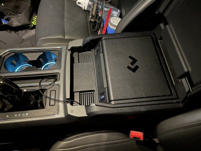

Final Thoughts: An outstanding product. Is it worth the price? For me, right off the bat I say yes. Personally, living in Florida you can't keep things like gum or Chapstick in your car pretty much from around April to October. Pumped that won't be an issue anymore for me anymore. I can also now keep a regular ass stick of deodorant in the truck as a backup rather than having to use spray on shit that smells almost as prepubescent as Axe Chocolate, circa Middle School 2003. Although I'm in project management, I do work in Construction Management and end up on jobsites quite often. I'll keep a gel pack in here during the summer to cool down quickly after a walk. The uses for me, in Florida, make it worth it.
I think the major downside for some is going to be that you lose most of your center console storage, you can put a phone or something else small on the little tray in front. For me, I got over that real quick when I looked around and realized the ungodly amount of storage our trucks have. This actually turned into a positive for me because the fridge is going to force me to have a home for everything in the doors, side center console slots, front center console storage, glove box, etc. I'm actually pumped for it because I already have ideas for things like making a Velcro strap mount for the winch controller in the passenger door for example. Now I do need new lockable storage for my gun, but I'm thinking of making a custom molded lid to the center console as it appears there's room under there. Next project? Yup!
