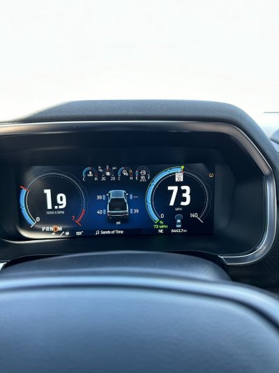

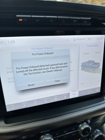

Bought my truck new October 2023 and I’ve been dealing with the same issue since day 1. Typically, it only happens when doing longer trips like on the highway I’ll be driving for 15-20 minutes and I’ll get a notice on the dash that my TPMS is faulty and one of the PSI numbers will go blank. I’ve had the truck in to dealer 3-4 times now for the same problem and they assumed that just replacing the sensors would be the fix but I’m still dealing with it. Recently I found that if one of the sensors goes blank and I turn off the pro power on board, the pressure will magically reappear on the dash. I also ran the pro power test and it’s detected a ground fault. Any advice is much appreciated IMG_8871.jpegIMG_8587.jpeg
