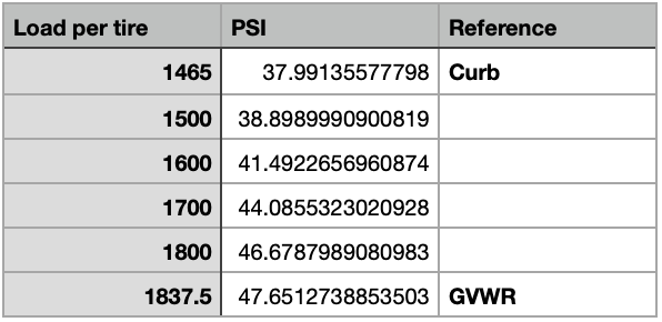

For the 801A Gen3 config, the estimated weight per tire is;
- Curb weight: 5,863lbs --> 1465.75 per tire
- GVWR: 7350lbs --> 1837.5 per tire
Trying to make some sense of this.. using the Load Inflation Table for LT315/70R17C, I calculated the "rate of change" or "slope" of the line from 35PSI to 45PSI (i.e., 0.0259326660600546). Then used this to calculate the PSI based on the Raptor's load (see table below). This leaves us with some alignment to the door jamb's recommended 38PSI.. Though at GVWR, the c-load tire does exceed its max inflation recommendation at 47.6PSI --> meaning if you're running at GVWR often, likely you should be upgrading to "D load" tires.
So what does this mean for my application?
Curb Weight + Camper + Humans + Gear -->
5,863 + 375 + 300 + 450 --> 6,888
That is about 1,722 lbs per tire. So I should be increasing all four tires to near Max PSI -- about 44?
Can anyone educate me as to what I may be overlooking here? Is there a simpler way to figure this out? Or any general guidance when adding say 250, 500, 750 lbs of gear to the truck how should we adjust tire pressure?
I know folks are going to point me to the chalk test :) but wondering if there was a quantitive approach to all of this..
I'll be headed on a trip this weekend, will look for open scales to get a quick measurement.
