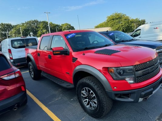

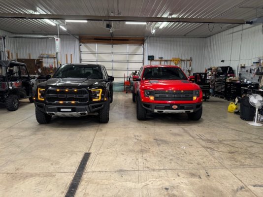

Always loved the Gen 1 but didn't get into the Raptor world until a 2017 Gen 2. Love the 2, minimal mods. Jump to this year, got rid of a plow truck we had for our 500 ft driveway and bought a side by side with a plow and put a snow blower on a tractor so we are set for the northern IN winters. Wife said go for a Gen 1 for a daily driver and new toy to play with (she has a Grand Cherokee for a winter driver and a Jeep JL). Found a Race Red with OK mileage of 140K locally at a Ford dealer. Worked out the details, they replaced the front shocks, ball joints, lower control arms, all plugs and coils. Still able to get a Ford warranty so thought why not on this high of mileage. She isn't perfect, already have a shop ready to replace the rockers since they paint is popping and I don't have a spray booth in the shop. Interior is clean and non smoker truck so all is good. I love the 6.2, had the same motor in my 2012 HD F150.image0.jpegimage2.jpegimage1.jpeg
