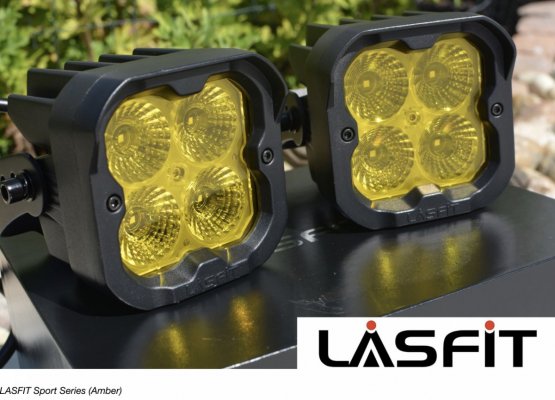

LASFIT, a company that is know for replacement LED bulbs at great prices, little did I know (and maybe you), they also began producing off-road lighting. Specifically I was interested in running their 3” pod lights, which can be purchased for around $130. LASFIT often runs sales and these can be picked up for as cheap as $116. When you compare that to Baja Design Squadron sports, priced at $249, the savings can really start adding up, especially if your goal is to run multiple setups. LASFIT also has an HP (high performance) lineup that is priced at around $249.
I want to be transparent with this review. LASFIT sent me both a set of 3” Sport and HP pod lights at a discounted price, but at no point did they attempt to influence my review. Now that that is out of the way, the question is, how do these stack up against the bigger, more expensive lights on the market? I am going to break this down into a few different segments, so feel free to jump to the ones that interest you most.

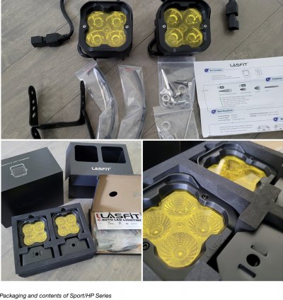

Whether you choose the Sport Series or the HP Series, you will be receiving a pair of 3” LED pods, 2 pigtails, mounting brackets, and hardware (including Allen keys). The lights are constructed out of aluminum with a very nice black powder coated finish. Please note that a harness is not included and normally adds around $15 to your cost if you do need it. The good news is that the harness includes a switch to get you up and running easily. LASFIT really has some nice packaging and it makes you feel like the quality is there.
My initial impression of the lights is that they feel like a quality product that will stand up to the elements, they even carry a IP67 waterproof and impact rating. The lenses are nice and thick and can be swapped out between clear, amber, and yellow with the provided Allen key. One thing to note between the HP and Sport Series is that the HP comes with stainless steel hardware while the Sport has black hardware.

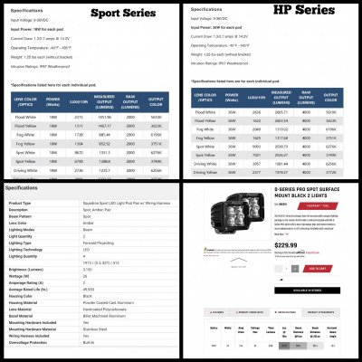

What’s a review if we are not going to compare specs between other options on the market to get a real idea just how well these stack up to the competition? I feel a fair comparison is to focus on the entry level lineups of a few different manufacturers, but I will be throwing LASFIT’S HP series in the ring because in terms of cost, it is priced equally with the others.
From a raw lumens standpoint we can see that the BD squadrons and the Rigid D Series Pro are nearly equal in output and beat out the LASFIT sports by about 1150 lumens. Stepping up to the HP series, the output is 850 lumens more for the same price. The BD and Rigid’s have limited lifetime warranties, while LASFIT offers a 3 year hassle free warranty.

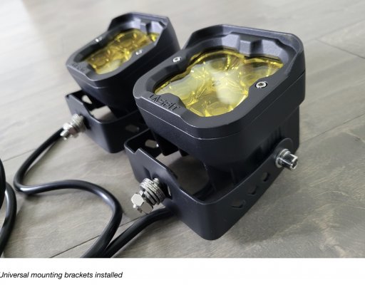

Install the universal mounting bracket to the pod itself using the supplied hardware and Allen key (I recommend you wait to fully tighten them before properly aiming them).
Step 2

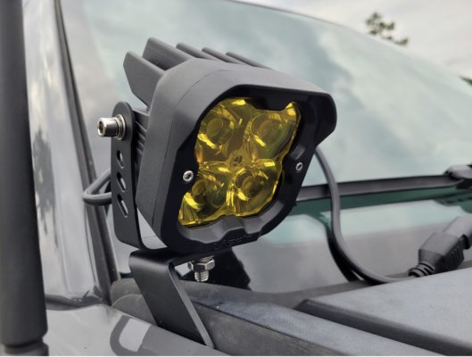

Mount the light to your bracket of choice (A-pillar, fog, grill, etc.) using the supplied hardware and 14mm wrench (a ratcheting wrench makes life a little easier). I chose to mount mine to my pre-installed A-Pillar brackets (sold separately).

Run your wire connections to each pod light and plug them into the pod. For a clean look, run the wiring up to the wiper cowl and into the rubber flap pictured and used zip ties to secure it in other locations. Excess wiring on the passenger side was bundled and hidden behind the f irewall shielding. Run the switch wire and driver side pod wire across the cowl from the passenger side. The switch wire was then ran into the firewall (the most difficult part). Depending on how and where you run your switch, you may find the wire length a little too short.
