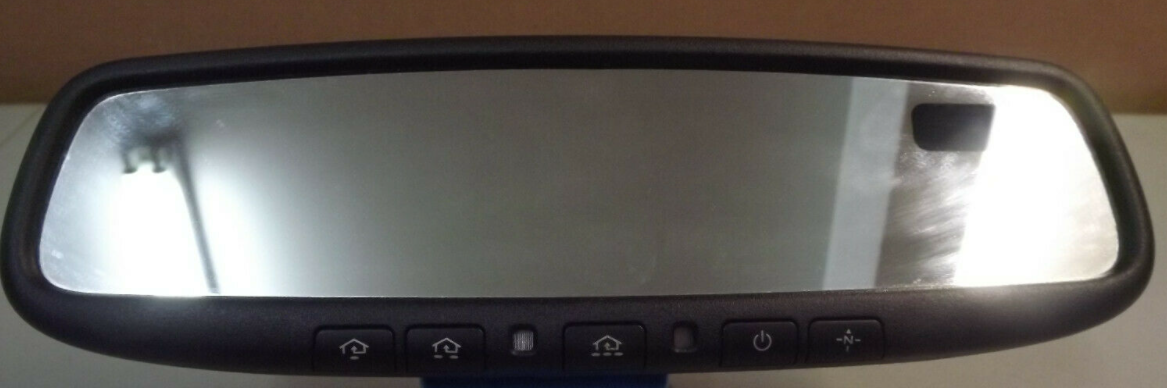

Gentex makes mirrors for most manufacturers (Nissan/Toyota/Honda etc.) and as luck would have it the mounting plate is exactly what we have in our F-150 Raptors. The specific mirror to get if you are going to do this is the Gentex 453 - It has a built in Compass, Auto Dimming, and 3 Homelink Programable Garage Door Opener buttons. You can find these all over Google, or eBay for $25-$50. Then price the Ford Visor with HomeLink, and you will see why I went this route :)
Gentex 453 Mirror - Note: You can get the Compass in Orange/Amber color, or a Blue/Green color LED

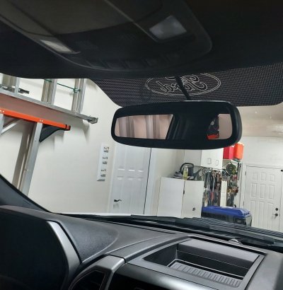

Gentex installed in place of OEM Mirror

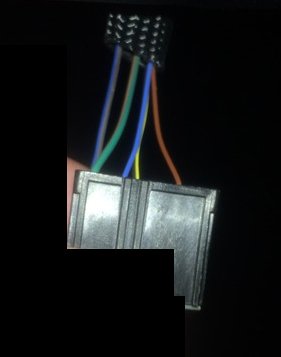

OEM Mirror Wiring/Connector

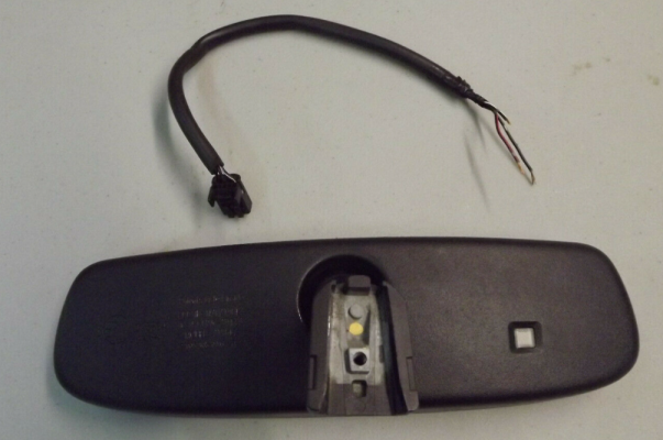

Gentex Wiring/Connector and back of mirror that slides on to windshield.
