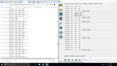

Hey guys, after a theft I'm having some trouble. Was wondering if anyone out there with a 2018 Raptor with the B&O sound system could confirm the ACM programming for me. See mine below. Truck got stolen, then recovered but was missing the amp/dsp and sub (from under the back seat). Also, main harness was cut. Dealer replaced the harness, all was well but waiting for stereo parts. Dealer put in new amp/dsp and sub when parts arrived but it doesn't sound right. Volume is low, mix is completely off (more bass up front than in back). Also, when they put the amp and sub in I lost all sonar, seat belt alarms. Pulled my as built file from ford, and as you can see in the picture it matches my current ACM programming. But I was wondering if any forscan users out there could just confirm for me that their ACM programming matches mine. PS, Backed up all my modules while I was in the system. Really strange thing was when I was done, sonar alarms came back, but sound system still sounds like crap... so strange. (and all I did was back up the modules) Below is my current ACM programming with my as built file data next to it. Any other thoughts would be greatly appreciated.unnamed.png

I've tried and I think I may have screwed a setting up, so back to the saved "as built" and then I can take a look again.
