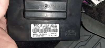

Good day gents,
Basically we had a problem with the IWE check valves. It turned out that the valve wasn't receiving any power supply because of the broken control box (pictures atatched). Then we ordered a new box from the US. But the box turned out to be not programmed, empty.
Therefore I would like to ask what options do we have since there is no official Ford service centre here in Kazakhstan. Maybe we can copy the program from the old box? Or programm it somehow, maybe buy the programm.
Looking forward to your replies.
Thank you.

Let me start out by asking what the original concern was as well as what year the truck is. Do you have a grinding noise under acceleration in 2WD? The TCCM (4x4 module) is not a common failure.

The truck is of year 2017. Yes, there was a grinding noise coming from the wheel hub. You can see another thread via the link below where that issue was discussed and we came up to the decision that the problem was with the IWE check valves, and that they were not working properly because they were not receiving enough energy.

I'm sorry for the late response. We've managed to programm the TCCM box (from the pictures above), and also changedthe solenoid valve. But the noise is still present.
