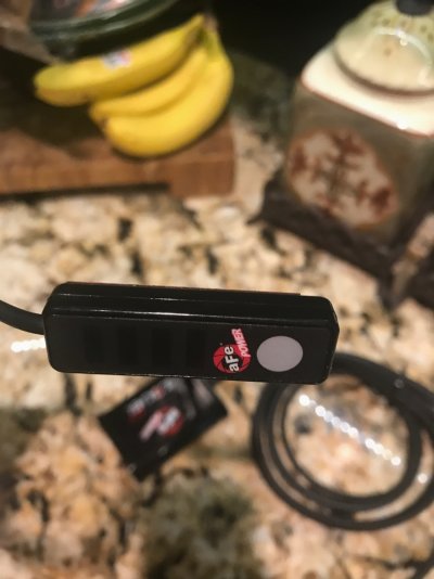

Instal was pretty straight forward and took about 30 min. Side note, I have installed two JMS boostmax's so it went smother this go round. I chose to start in the cab by locating a home for the control switch to the left of the wheel, as I have an 802A so push button is in the way in the other side. b233e6bf1cedb67457f14f43bc81e4a5.jpg

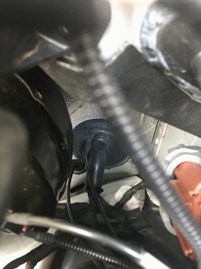

I had already cut a small slice in the rubber grommet located on firewall driver side and just under the break booster for the boostmax so I used the same spot for this install.
Picture of engine grommet

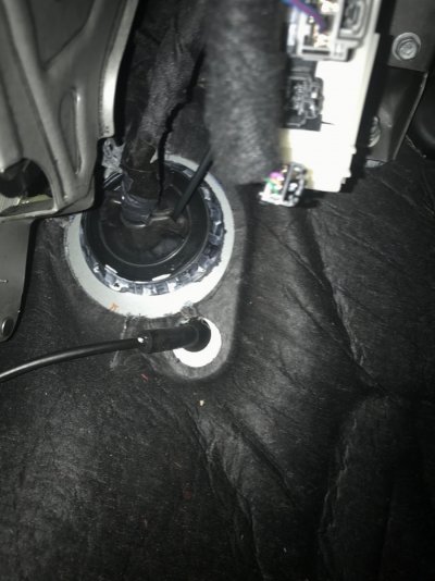

I chose to not cut the inside grommet located under the driver side dash but rather use the same path the harness runs.
I would note that you need to pay special attention to not cut or puncture the trucks wire harness. I went to the left side of it in the engine bay and used a hanger with a hook and tape to fish it through....by far the hardest part!!

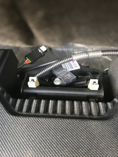

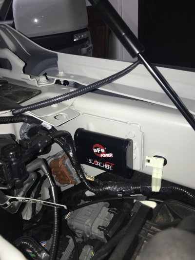

Once that's done, you need to choose a location to mount the main box in the engine bay. There is plenty of cable for the tmap and map sensors but not much to reach back to the control switch located in the cab so I chose the driver side. See pic

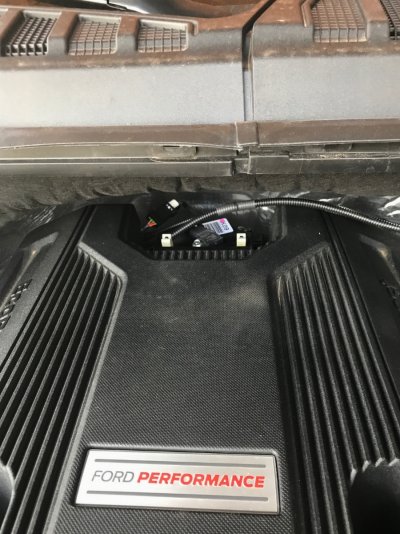

Next, you simply run the main harness along the firewall to the map switch located on the back of the engine

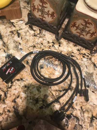

The Scorcher has two connections, one that you plug into the sensor and one that you plug into the trucks harness. So in short, you are putting the Scorcher inline with the sensor and the trucks harness.

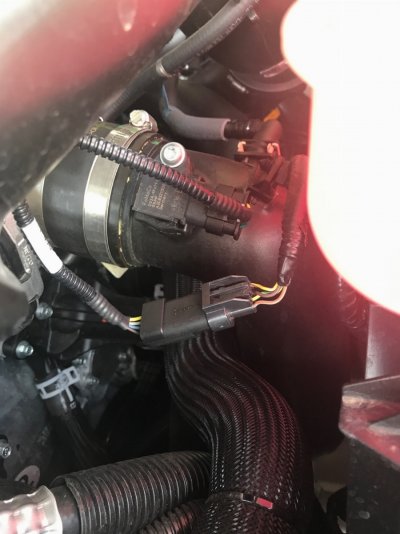

You then run the harness along the top of the engine up to the front, I did not get a picture with the engine cover off but I chose the route along the left side as there are other wires routed that way and it's an easy place to zip tie to. Once up front you then unplug the tmap sensors and insert the Scorcher inline with it, unplug sensors, plug in Scorcher connection and the plug the truck harness into the other Scorcher conection.
