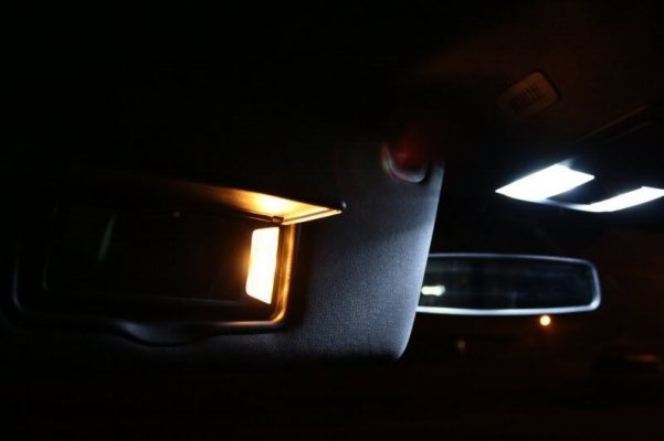

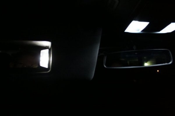

For the map lights by the rear view mirror it takes TWO 194 bulbs, the one I got has 6 Samsung LEDs on it.
http://www.ebay.com/itm/23088515002...d=link&campid=5338805043&toolid=20001&mkevt=1
For the dome lights, I used one 42mm festoon type 6-SMD Samsung LED bulbs. SCrew trucks have 3 bulbs.
4 42mm 16 SMD LED White Car Dome Festoon Interior Light Bulb | eBay

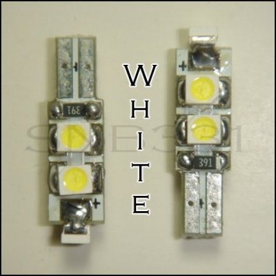

For the vanity mirror lights I used #74 bulbs with 4 SMD LEDs, my truck took 2 total, only 1 light per mirror.
http://www.ebay.com/itm/11096818788...d=link&campid=5338805043&toolid=20001&mkevt=1

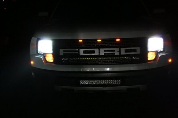

EXTERIOR (FRONT)

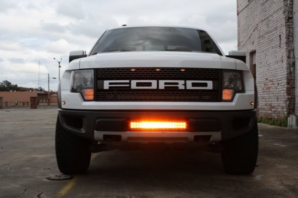

Front signals are 3157 bulbs, I bought a pair of 54-SMD LED amber bulbs. By doing this, I had no flasher issues on my truck.
2X Amber 3156 3157 SMD 54 LED Corner Signal Brake Blinker Light Bulbs | eBay
Front side markers are 194 size bulbs, I bought a pair of 5-SMD LED amber bulbs.
2pcs 168 194 T10 5 SMD Amber Orange LED Parking Light Bulbs Interior USA SHIP | eBay

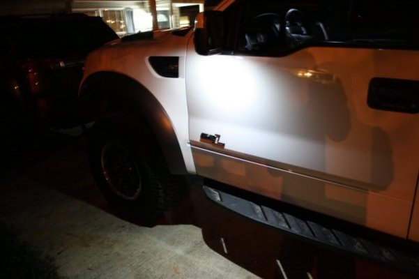

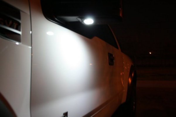

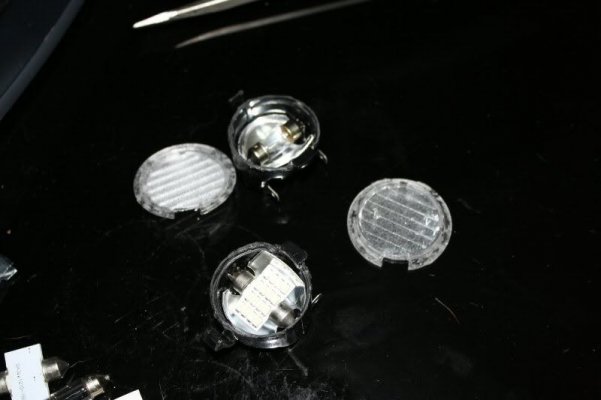

Puddle lights, I used 31mm festoon you have to cut the lense off them and once that is done you can replace the bulbs, all plug & play. Just make sure to seal it up good, I used some 5min epoxy to seal mine up.
2X White Dome 16 LED 3528 SMD Festoon Interior Bulb Light 31mm DC 12V New | eBay

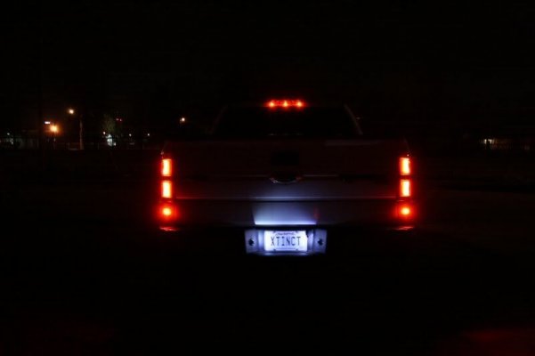

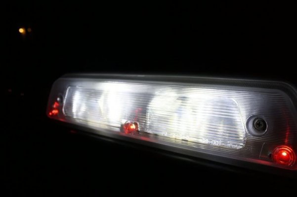

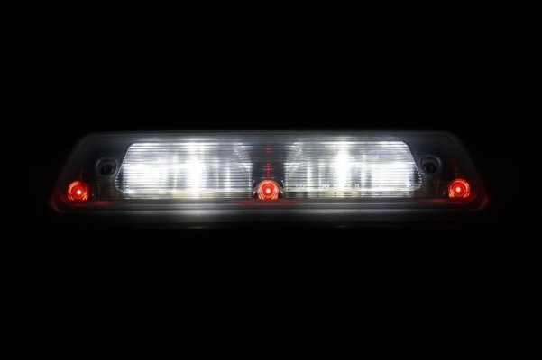

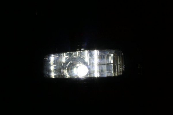

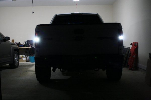

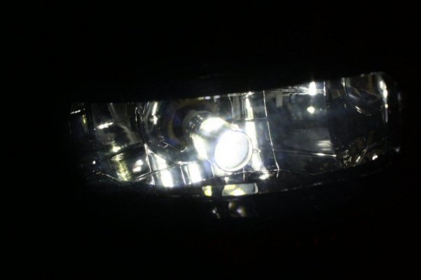

Cargo and reverse lights I used 921/194 bulbs, bought a pair of 25W LED white bulbs.
http://www.ebay.com/itm/37116020793...d=link&campid=5338805043&toolid=20001&mkevt=1

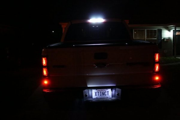

License plate lights, used a pair of 194 Samsung LED bulbs that I used for my map lights above.

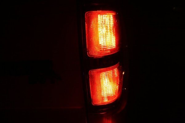

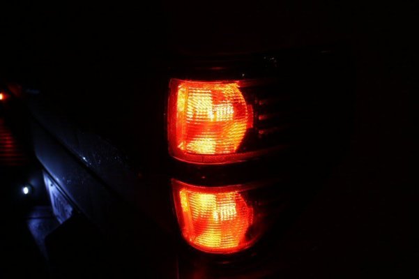

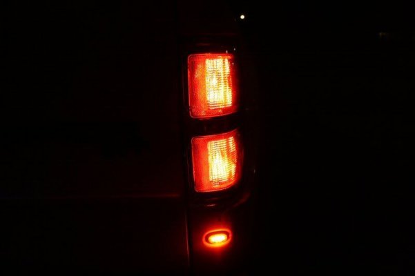

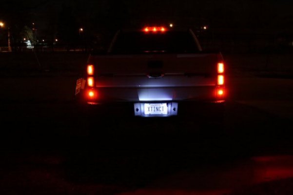

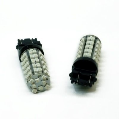

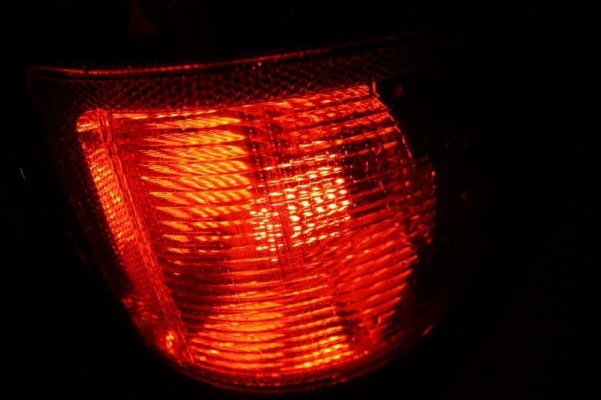

I installed four 68-SMD LED red bulbs, just installed and not sure on signal action as of yet... WILL UPDATE
GP Thunder Pair 3157 3057 4157 SMD 68 LED Lights Bulbs Red | eBay
Quick run down of bulb pictures for when the eBay links go bad in a few months. They're in order as I listed above

EXTERIOR (FRONT)
EXTERIOR (REAR)

INTERIOR
2010 Raptor Interior LED Lights - YouTube
EXTERIOR (FRONT)
2010 Raptor LED Retrofit Puddle Lights - YouTube
EXTERIOR (REAR)

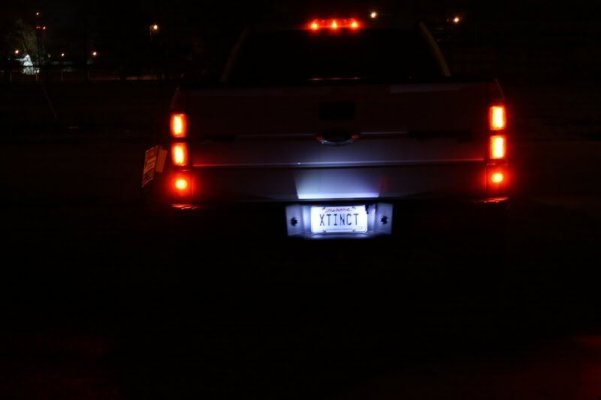

Stock bulbs left, LED right.
Inside Shot Of LEDs
Both sides installed

How's the color on the front ambers? Do the match well with the marker lights, or are they a different shade of amber? Also can't wait to see if the 13W fit the reverse bulbs. I'm gonna try to find a website that sells em because I'm not a fan of ebay.

1- Taillights, why did you get red? Why not white since they're behind the red reflector?
2- Your link for the cargo lamps you say they're 13w, but the ebay link says "7w 11w 13w", and the pic you posted of the bulb looks like it's the 1 * 3w Cree + 4 * 1.5w Plasma which equals 9w, which doesn't match 7, 11, or 13 lol.
3- Reverse lights. I'm interested to see if the 13w ones fit in there, or if that 7.5w one you linked is the biggest/brightest.

For the front signals, damn near a perfect match. Couldn't have asked for a better match, 99% identical to stock LEDs. Also when off, it appears completely white inside too which is nice.

1 - got red because from years of dealing with LEDs, if you have a red lense then red is the way to go. White LEDs wouldn't appear as "red" as you'd hope, by having red LEDs it just adds more depth to the light.
2 - That auction actually is for 3 different bulbs, you want the one like I posted... Has 4x 1.5w LEDs on sides plus a 7w LED facing rear
3 - I'll test them this weekend and see if they fit. I think they're 0.3" longer, which doesn't appear to fit in there visually BUT I saw another thread and I think they may barely fit. The 13w barely fit in cargo lights too. :) If they fit, I'll be ordering another pair of them to swap out.

Good work man. You should be raptor owner of the month. Now, all I'm waiting for is the projection shots of the reverse lights and 13w in the reverse lights.
